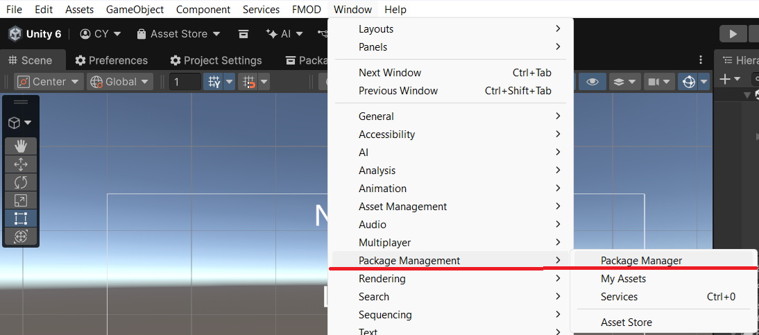

    • In the Unity Editor

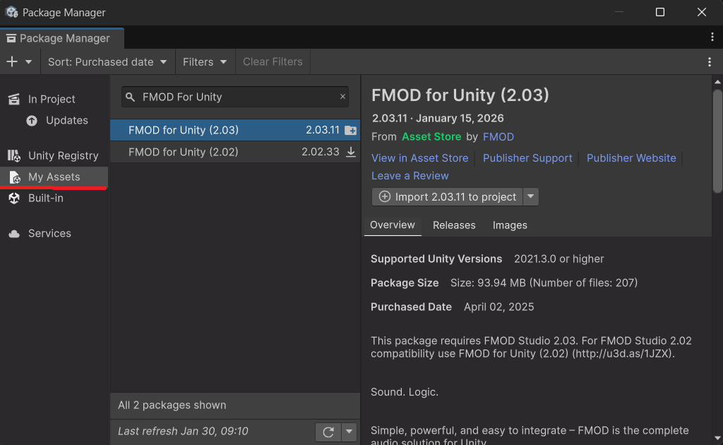

    • Open the Package Manager Unity Package Manager Open
    • In My Assets search for FMOD for Unity
    • Add your desired Major version FMOD for Unity
